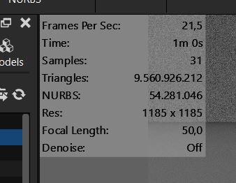

9.5 Billion triangles after import
I received a production plant from a CAD system. as a step file. Lots of parts. File size is 64MB. Not a lot.
I imported NURBS and set the quality to 0.3.
9.5 Billion triangles!!!

I imported the whole scene in 0.01 quality but every part is now in 0.1 tessellated.
I’m running V 2024. I can lower single parts to 0.01 but the machine can’t handle the process. Once it crashed and it stops mostly.
And this is with my new computer with 80 cores and 384 Gb Ram.
If I manually lower one part and make a pattern it’s lighter. But I think there are problems with the model. I heard now that it was imported and exported through different CAD systems and they already fixed it.
